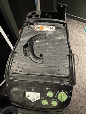

Hi
Does the CT-VA-20 require a T-LOC interface to lock in place, or will it work as is? Has anyone here successfully used it with an older CTM 36 without modifications?
I have searched a lot and I can’t find a picture of a retrofit part to get t-loc system for the CTM 36 E AC HD.
Anyone been through this and know what i need? What is the solution?

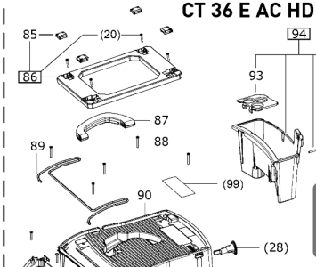

Hi, looks like adaptor plate #86 plus#85 plus#20 holds the systainer in place. ekat in the uk wants tr no. and part so no number i could find. here's a picture of parts and actual part on the ct. good luck
I think the total of that 86, 85, 20 is the number I posted before; 768115
