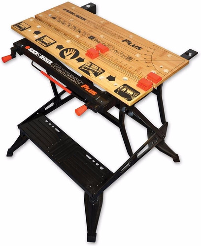

It is 30+ years old and has never fully retired.  I use it regularly for doweling on cabinet cases.  Still very handy.
Note:  This is not the exact model that I have.  They probably do not still make the one I use.

I still have mine and use it from time to time. I used it today in fact. Mine is also an older model, I bought it in 1978, but it's still in very good shape. I was in the second year of my apprenticeship; didn't have a lot of money; and rented a small house from a friend. There was no room for a shop and no garage so the only place I had to work was outside or in the mechanical room with the boiler and the water heater. I think there was maybe 30 sq. feet of open space in that room. If I had a long board to cut I had to let the end hang out the door to the outside. Didn't work so well in Winter.  [sad]
The dog holes are 20mm surprisingly. Well maybe not since they originator was in England. But all my modern day 20mm clamps and dogs fit perfectly.
