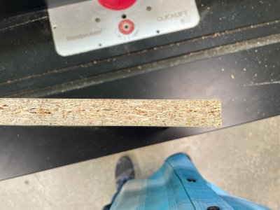

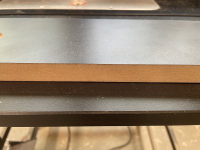

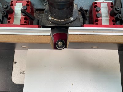

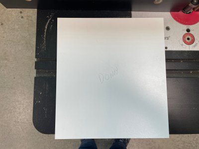

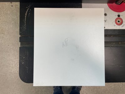

Some results for you on melamine with the 4-Flute Alternating Shears. To me, they look very encouraging.
Top side cut. All four edges.
Bottom of cut. All four edges.
Edge.
Depth of cut taken.
Same results in MDF core black.
