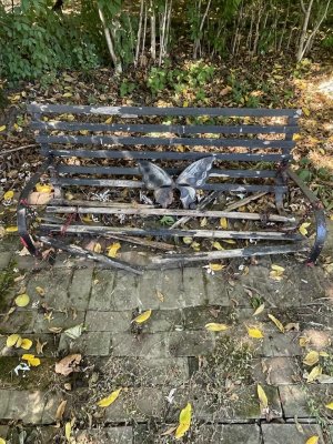

For the last few decades, most of the focus was on cabinets and Architectural features/fixtures. I suppose, to some degree, part of it could be called furniture? Though that's not how I see it. I have done a few actual furniture projects, but they were for friends/family or myself. They were all side projects though.
My latest project, in the home shop is essentially a commissioned piece. It's not really though, since it's a favor for my daughter's back yard. That makes it a job that not only doesn't pay.....it's costing me.

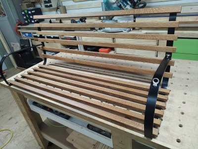

It's a simple thing that I decided to take "over the top", while remaining true to the original. It's a simple metal-arm swing-bench.
It's far older than she is, always in the back yard, as a child. It went to her when she bought her own house, a few years ago.
It has had a rough life, out in the weather for decades.
When I was asked to fix it for her, a few of the cross slats were broken, but all of them were water damaged. (split/rotted)

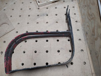

It was painted originally, but it was requested to make it better. However, I had no clue how crudely this thing was built.
The only part I was saving was the metal frames/arms. Apparently, it was "home made", but who knows when?
Once it was apart, the arms don't even match each other. I cut the weld joint of one and evened them out as much as possible.

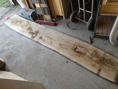

All the while, in search of some White Oak. A former co-worker runs a little side business cutting and drying lumber. He had a nice stack, in one of his storage areas. I got 3 pretty large pieces from him. They were air dried and of course rough.
I got them home and the actual work started. Turns out they really were dry enough to use, under 8%.

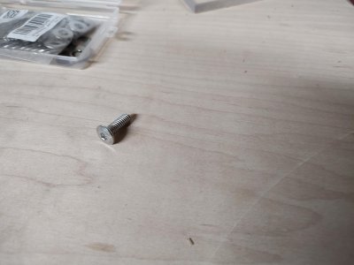

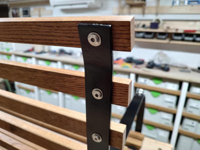

The original slats were through-bolted, with carriage bolts, long since sunk into the wood, looking bad, and even rusting, paint notwithstanding.
I chose to use threaded inserts, from the back, and nice stainless steel hardware, chains and all. The custom blended hardwax-oil, that I made for it, is still curing, so it hasn't been returned or reinstalled yet. For an indoor piece, it would be fine, but to sit out in the weather (getting into the 30s at night) not yet.

I'll get a pic of the bolts, from the back, when I hang it. They are really low profile, flatter than a carriage bolt, with a 4mm hex.

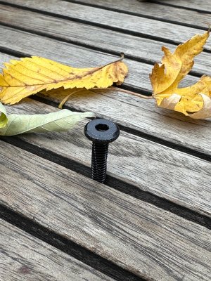

Love the use of hidden fasteners along with threaded inserts, that adds years upon years of maintenance free use. (y)

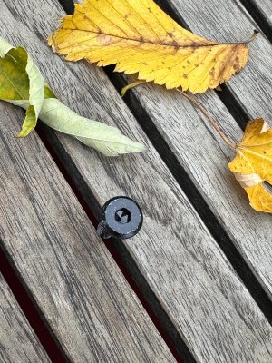

You mentioned low profile head fasteners with hex drives, do they look like these?

White Oak is great for outdoor projects. It is more rot resistant than most other types of timber. Red is the bad one. It is very much like a bunch of straws, pulling moisture right up in it.

@Cheese They are very similar, but not quite as heavy duty.
Ya, just curious because despite being painted black, they're manufactured from 410 stainless so that they're magnetic. Just perfect for an upcoming aluminum fence gate project that's in the works. What caught my attention besides being manufactured from 410 SST was the thin profile thickness of the head, the large head diameter and the hex drive, a great combination of features for so many applications. :)
