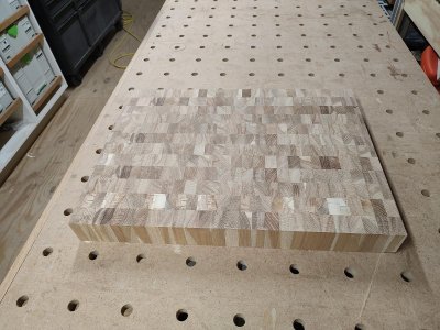

First in the home shop. This one was commissioned, buy a guy who is dabbling in amateur butchering.
It is completely glued up and flattened. Now it gets a juice groove and collection well. I got the location nailed down today.
I'm also working on a new hand-hold for the ends. It will probably be a variation of my finger dimple idea.
I have been accused of that being a signature thing? That was never the intent, but ok.
It's a monster, 18" x 24" x 2 3/4" thick.

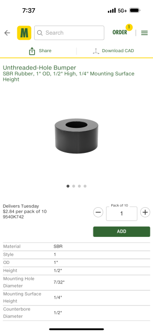

@Crazyraceguy i have been using these on lamp bases for a while. If you are making that one sided. They would be a good choice for feet rubber about 1/2 inch tall. Non slip.
Use a wood screw and washer to attach.

How big are those feet? I have some, that I use for cutting boards, but they are probable too small for this thing?

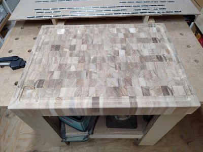

@waho6o9 I sure will. Here a 2 more, with today's progress. It still needs some refinement, but it's mostly there.
Grips tomorrow

Those feet are 1 inch in diameter and 1/2 high but McMaster has ones that go up to 2 1/2 inches in diameter and 1 inch high.
The advantage of raising the base off a surface makes it easier to grab. Just grab a router and rout a shallower recess on opposite sides.
Ron

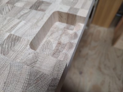

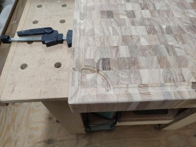

I have only done one side so far, but this is what I came up with for the handles.
It goes in further than the one with the individual loops, but kind of does a call-back, with the grippy edge. It's essentially half-circle ridges.
Ron that sounds more proportionate than the ones I already have. cutting board grip.jpgmuch more

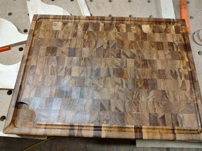

Just a mineral oil bath and then a bit of wax was it?
I don't have anything big enough for that thing to get a bath....lol
I put it up on some spacers and just kept at it, from the bottom, until it started to seep out the top. Then I turned it over and hit the other side a few times. It had already taken quite a bit, so that went faster. After that It went at it with a mineral oil/beeswax blend. It was one from the last batch I mixed. It' pretty soft, in the can, spreads readily, but not so loose that it levels out again.
