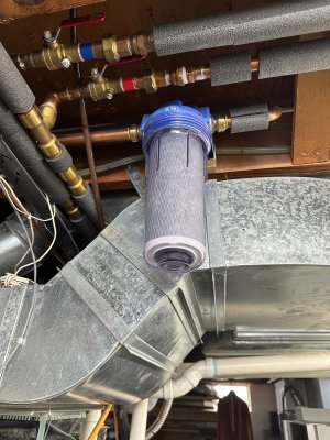

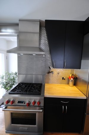

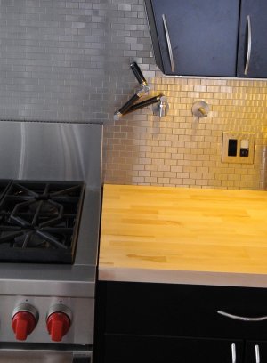

Actually, I installed one "near" the range and consider it to be one of the best moves I've made. It's connected to a 10" water filter downstairs that contains a 0.5 micron carbon block filter element. The filter cartridge is rated for Chlorine Taste & Odor, Giardia/Cryptosporidium, Cyst, Taste & Odor, Rust Particles and Sediment
The "pot filler" is used for all cooking water, along with all pet food/dish water, drinking water, coffee & tea water and all the water for the plants. The ice maker in the freezer is also attached to the carbon block filter. I performed a quick usage study and found that the pot filler provides about 18 gallons of water per week or about 450 gallons per 6 months which is perfect for the filter I'm using.

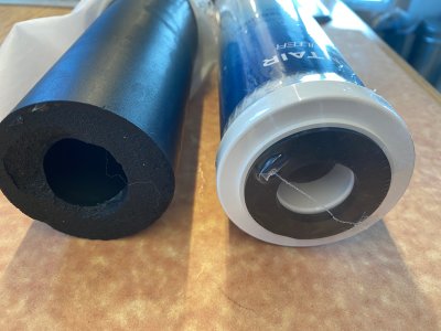

Once the outer wrappings are removed from the filter, you understand why these are called carbon block filters. :D The filter is a hollow 3/4" thick wall chunk of carbon 10" long.

As I became older and smarter? I placed the filter housing downstairs next to a cold air return so that you'd never hit your head on either the cold air return or the water filter housing unless you were an idiot. It was also easier to change water filter elements overhead while standing on a short Systainer as opposed to changing them from underneath the kitchen sink lying on your back...that 90's solution was always a mystery to me.
And your parents choice of filter location under the sink is not unusual as the current filter manufacturers to this day still refer to the filter systems they sell as being for "under cabinet installation". Sheesh...let's make this whole process easier. Catch the clue bus...when you change out water filter elements there will always be some water spillage, it's inevitable and unless the underside of the sink cavity is totally enclosed in rubber, you'll be mopping up water.

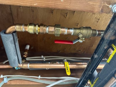

So here's my riff on the situation:
Whole house water filter installed downstairs for easy access, 3/4" copper lines with large radius elbows (tubas) for maximum water flow, hot & cold water lines marked with colored tape, all ball valves located next to the area they serve for ease of control.

How often do the filter cartridges have to be replaced?
Once every 4-6 months...you can easily tell when it's time to change the filter because filling up a pasta pentola takes longer than normal. It's also obvious in the flavor of the water, there's something off with the taste.
How easily are they replaced?
Everything I need to change the filter is within a foot of the filter. To change the filter, I shut the ball valve, remove the water pressure by pressing a button on the filter housing, unscrew the lower housing, remove the old filter, insert a new filter, reattach the lower housing and open up the ball valve.
Typically though, once removed, I'll wash the lower housing in soapy water and rinse it thoroughly. I'll then fill the lower housing with clean water and let the new carbon block filter soak in it for 3-4 minutes while I'm cleaning the o-ring. I then wipe a very small amount of Vaseline on the o-ring before I reinstall it in the lower housing and screw the housing back on. It's really an under 10 minute affair all done in the standing position. :D
