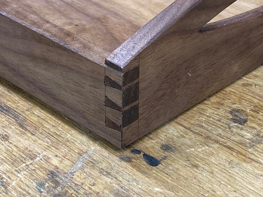

I am not sure why it is, but few of the furniture/case or box builds I see on YouTube or websites feature mitred dovetails. It is usually only simple through dovetails or half blind dovetails. Using half blind dovetails at the front of a drawer is obvious, as is the simple through dovetail for the drawer back. Ploughing a groove for the drawer bottom (if not using slips) is straight forward here since the groove is hidden inside the half blind front.
But this is so with cases and boxes utilising through dovetails. Without a mitre to hide the groove inside, one must use a stopped groove, and this is cumbersome to make with hand tools. Not to mention the fact that mitred ends look better than stumpy square ends. I routinely use mitred through dovetails. They are more work, in fact, I think they require a lot more care when sawing. But, like everything, it gets easier with practice.

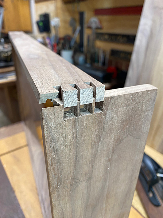

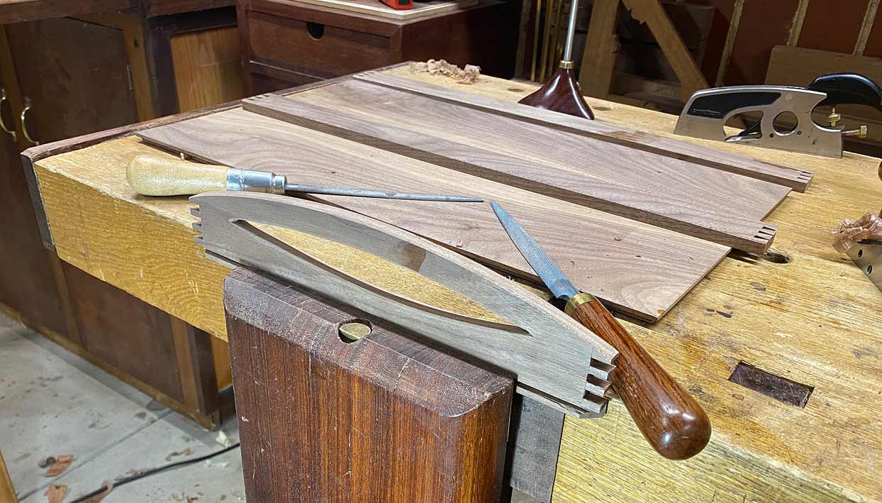

Dovetails ...

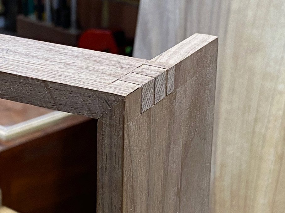

Grooving the sides ...

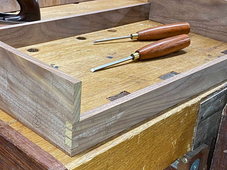

Fitting together ...
Four sides ...

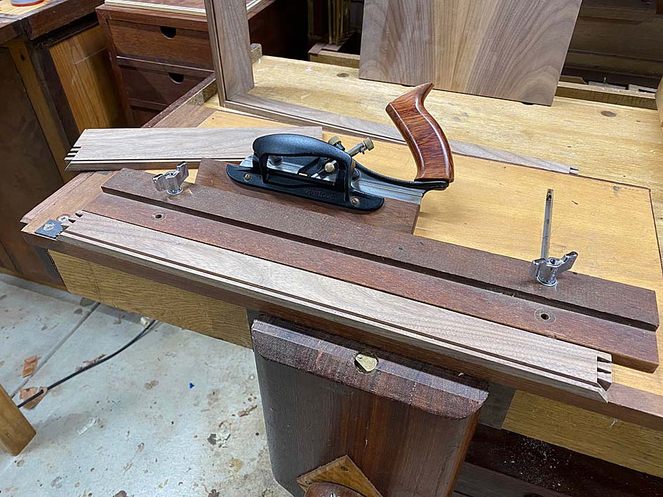

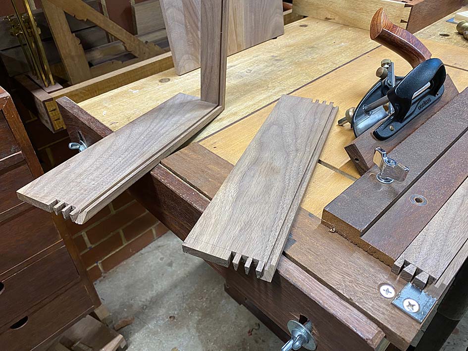

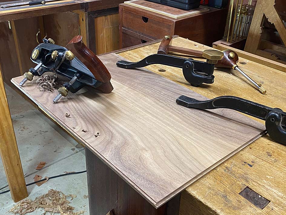

Rebating the tray bottom with a Veritas Skew Rabbet Plane. The bottom is 7mm thick and the rebates are 3mm wide and deep ...

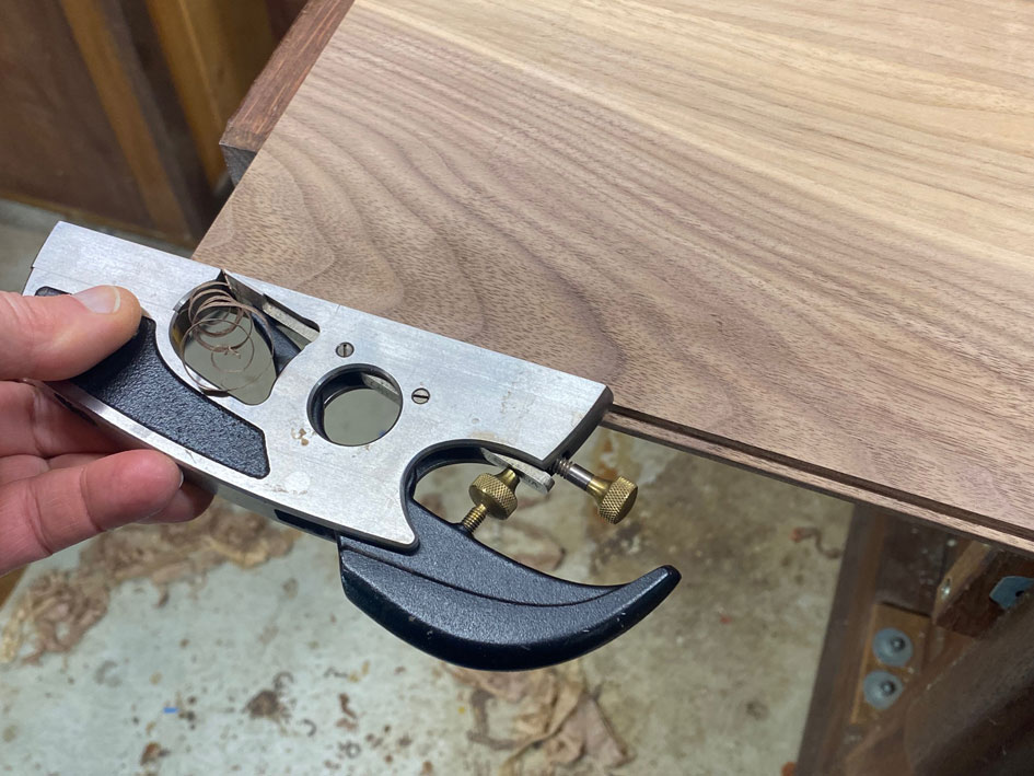

This is where a shoulder plane is best used ... to clean and tune rebates ...

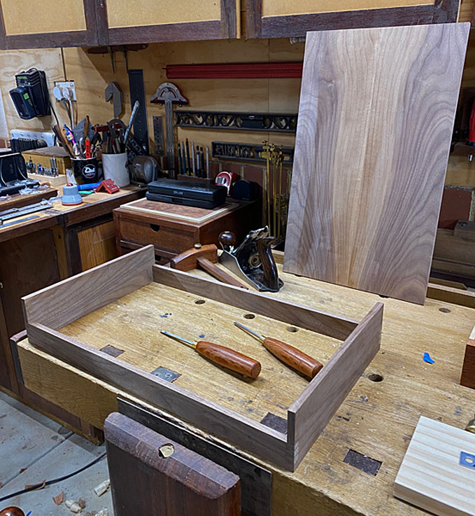

The fit ...

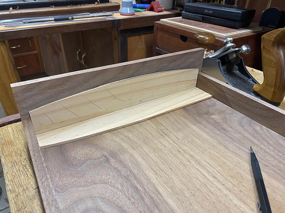

The next stage is for the ends to be shaped. In this photo a template is create to make a uniform curve ...
Cut out, smoothed, and then fretsawed out and finally finished with rasps and sand paper ...

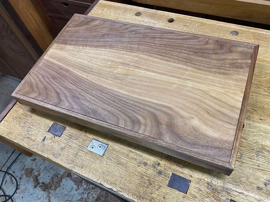

The underside ...

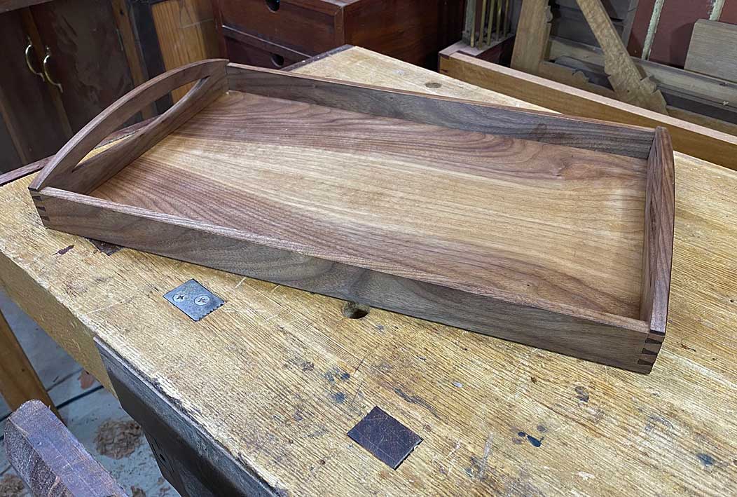

The joinery is not glued but really solid. Very pleased with this. Some dusty mitred through dovetails ...

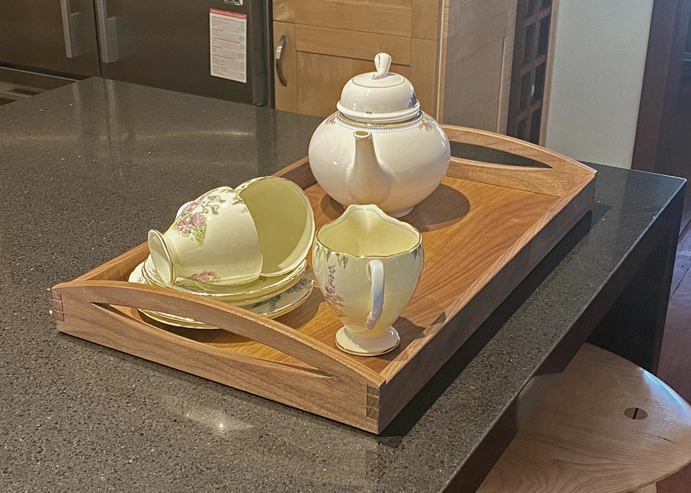

Job done with one coat of hard wax oil ...

Dovetails ...
Four sides ...

The underside ...
