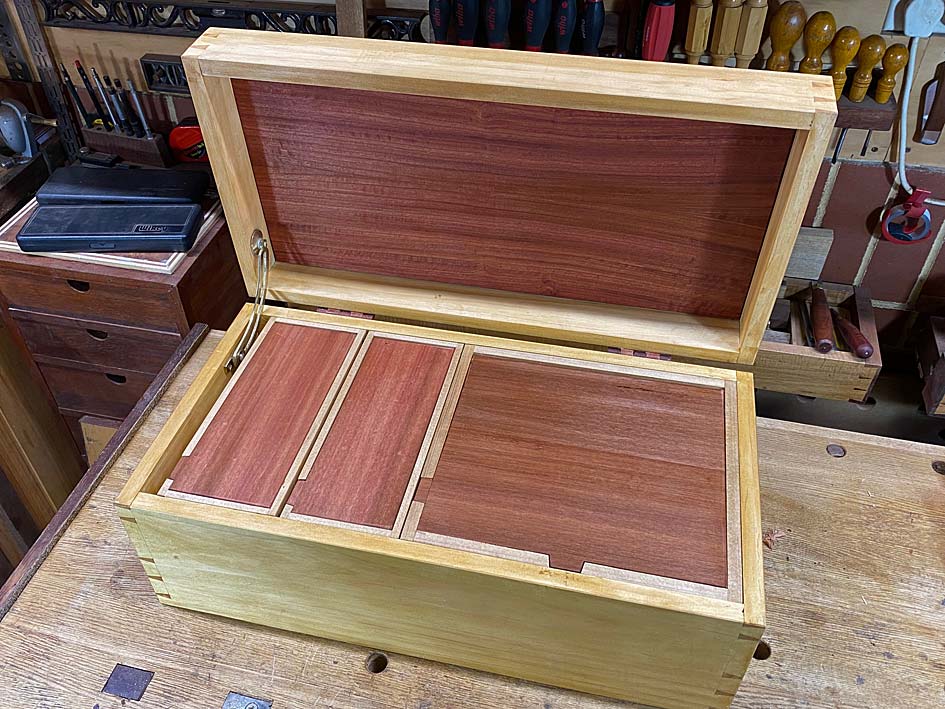

A little more progress with the pine and makore tool box. What may be of interest to those reading are the tools chosen to be included. The intention is that these are all that is needed to do fine work when building furniture - to cover joinery, such as rebates, mortise-and-tenons, dovetailing for cases and drawers, jointing and smoothing. The box is small, and the challenge is to fit everything inside, as well as keeping the weight down. So far the total is 7 kg.
The plan is to make all the tools in the tool box. The only exception here are marking tools, but I may change my mind later.
The top layer, comprising three boxes, is done ...
There is enough space to slide a box along and get a finger under the side latch to open it ...
