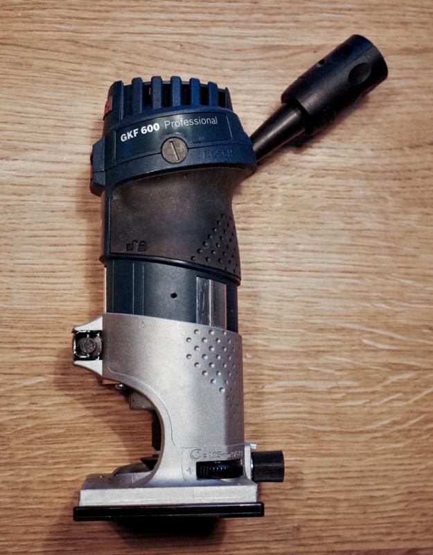

I was cutting a piece of metal box tube with an angle grinder the other day and the cut off piece fell to the floor and neatly severed the cable, So I thought if I now had a Festool cable I could just continue working without a repair break.
So I bought 3 new  491145 UBS-PUR 420 Plug It 240 V.
I installed these Years ago on my RO 150 E and OF 900 but was never rally happy with the amount of cable that hangs out the end of the handles.
Then I saw the Photos from Henrik R, I was especially interested in his Fine Multicut.
He had the two Rubber sleeves touching each other.
With the rotex 150 and the Bosch grinder the motor cover is removed by sliding it as one piece back down the cable.
I discovered on the Bosch Grinder that the Rubber cable protector could be pushed in to the housing and slipped over the rubber protector from the Festool Plug It adapter. Now the short piece of green cable that was sticking out of the rubber was inline with the screw down device. So I measured what I needed of uncovered seperated cable and cut the cable to length.
Installed it and pushed the Rubber part and cable back in to place and it fits a treat.
I now have a much more rigid connection point and not so much dangling cable in the way.
[attachimg=2]
I hadn't noticed the first time I could push the rubber cable protector in to the housing because it has a rubber attachment for the Allan key on it. So with a few clamps I managed to clamp it back.
[attachimg=3]
which now means it drags less over the work and is closer to the end of the hose when I use my "plug it" on my boom arm.
[attachimg=4]
On my rotex that had been annoying me for some years I managed to shorten the cable by 7,5 cm.
[attachimg=5]
