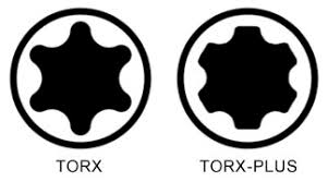

The torx driver you want is labelled TP20, its a common tool size the screws on lathe insert screws use. It is a slightly different geometry to the T20. A good set of Torx bits will include the TP range and well as the standard range.
This will help illustrate the difference. Funnily enough I just received a set yesterday as I was battling a similar problem last week.
