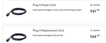

Perhaps this will help.  The more expensive is the thicker cord used by the TS saws and the 1400 router.  The less expensive one has the extra tab in the plug it end to prevent it from being used with higher amp machines.
[attachimg=#]
