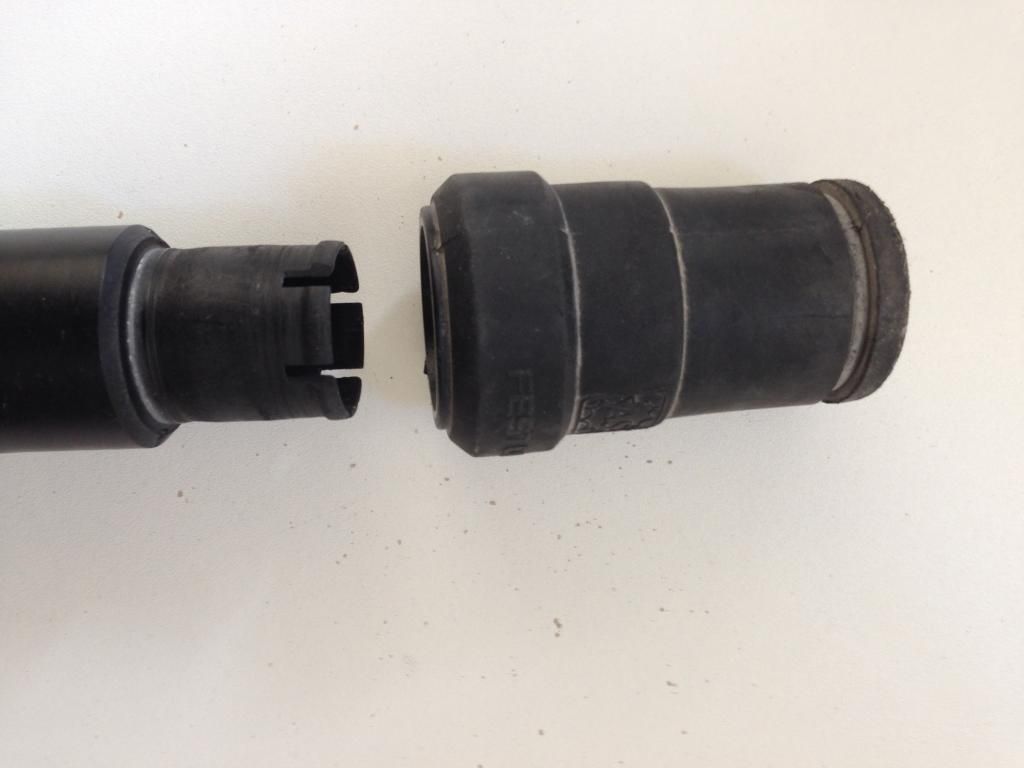

The tool end connector on the 22mm is unsatisfactory as it has the same outside shape as the standard connector, but a weak swivel part that should be held in with 6 lugs, but frequently becomes detached.  I have this hose as it came as standard with my CT Mini - I wouldn't bother going out to buy one.
For the hand sanding block (excellent btw), the best solution is a separate small bore hose that I just insert in the end of the main vac hose with a friction fit.  The small bore hose I bought from some specialist supplier online; it is much more whippy and does not have the chunky end connector.  The kit is elsewhere at the moment - I'll post a pic for you when I can, Peter.

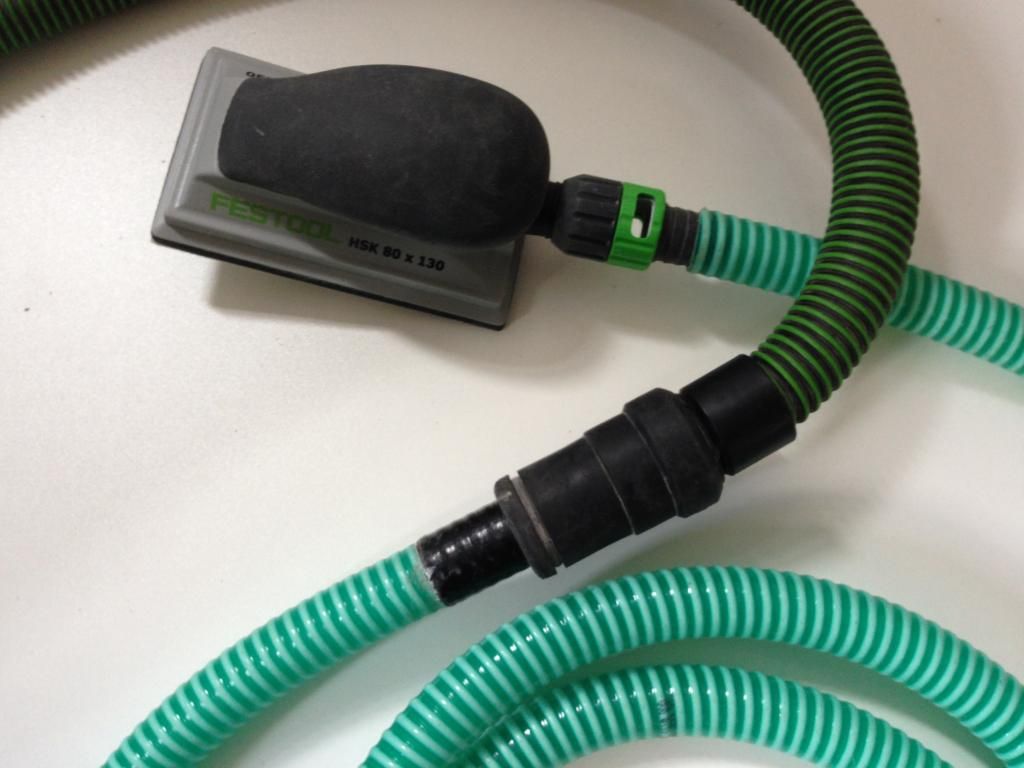

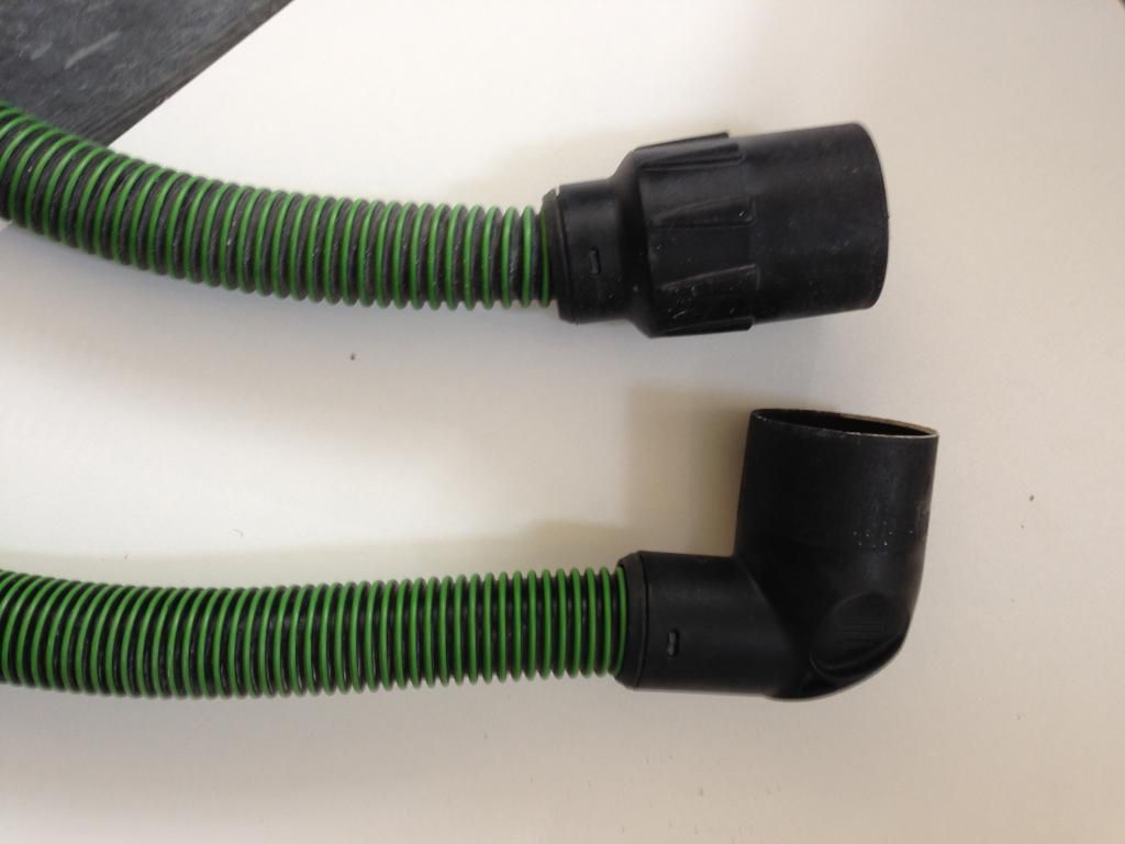

The 22mm hose I am referring to is part no 456745 as per the OP's question.  It came as standard on my CT Mini a good few years ago (now the Mini is supplied with the 27mm hose, I believe).  Here are a few pics alongside a 27mm hose - you can see the poor design of the tool connector.

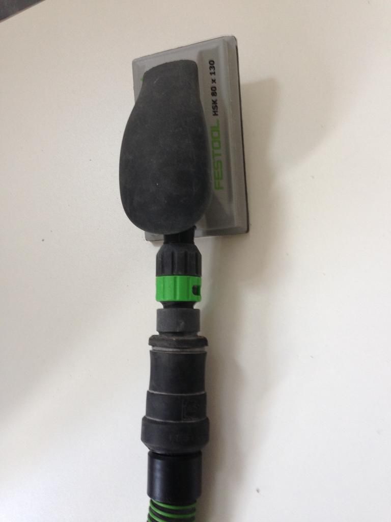

As regards the hand sanding block, I found even the 22mm hose too chunky, mostly due to the connector.  This is how I use it, compared to using the 22mm hose:
The hose I think came from here http://www.flextechhose.co.uk/t1800_flexhose_green-tint_suction_hose_pvc.html (I guess it was the smallest size).  It is not super flexible and the hose that Mirka sells might be better http://www.restexpress.co.uk/acatalog/Mirka_Abranet_Flexible_Hose.html?gclid=CMX_j-um4cECFUTmwgod-jUAHA except it's not green...
