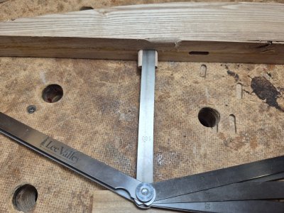

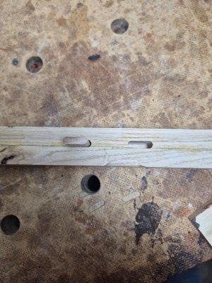

The 6mm CMT cutter from Amazon produced oversized/very loose mortises. The price was right, at half of Festool's. A local store also carries the same cutter by CMT at almost the same price of $35 Cdn, but I'm a bit hesitant to get it now.

What I thought too. Before I returned it, I made a few more mortises this morning and checked them with another batch of 6mm tenons. Even a sanded dry-fit tenon wouldn't remotely come close to being that loose.

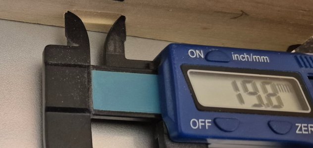

Just how loose the tenon was in the mortise milled in the narrow setting by the CMT cutter I had? The pictures show it clearly (0.005" or 0.127mm).

It not really economically advisable and it only works once. Since the overall length is reduced, the mortise will be narrower, once is barely usable. After seeing that, I quit sending them.

The other two settings would've resulted in much wider mortises. The critical issue was with the thickness of the mortises as the 0.127mm gap was way too much. A sheet of paper is 0.1mm thick.
My mistake, I glossed over your post with the feeler gauge.
Looks like the cutter was ground a little large.
