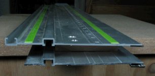

Question: I was offered an AP 55. It's base is clearly prepared for a track, but will this saw fit the current tracks? Or were they different way back when this saw was made?
The early tracks were different. The later tracks have an extra T slot on top, on the RHS of the track.
I have an 85 and it fits on both track types.
There is a fellow on the forum from christianholvn I think. So you may be able to try a rail.
Old and new rails.

Thank you everyone! That photo really answers everything.
