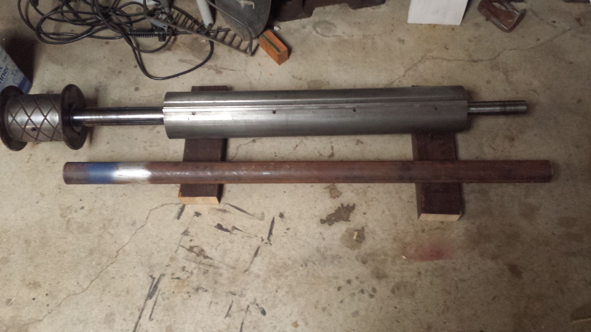

It turns out that my 30" jointer needed the bearings repoured.
First thing to do was buy a hunk of 4140 HTSR shaft to be used as a mandrel. Next, it and the cutter head had to go to my machinists so he could make it match the journals on the head and make me two retaining collars.

The mandrel is two fold, the cutter head is super freaking heavy and there is a possibility to spring the journals pouring the molten metal on them. I would not want to ruin that cutter block.
The collars were for two reasons, to keep the mandrel in place (I had to flip the shaft end for end to pour the opposite end bearings) and to help seal it. I only had to use some damming putty in a few places (the bluish purple stuff) to keep the babbit in.

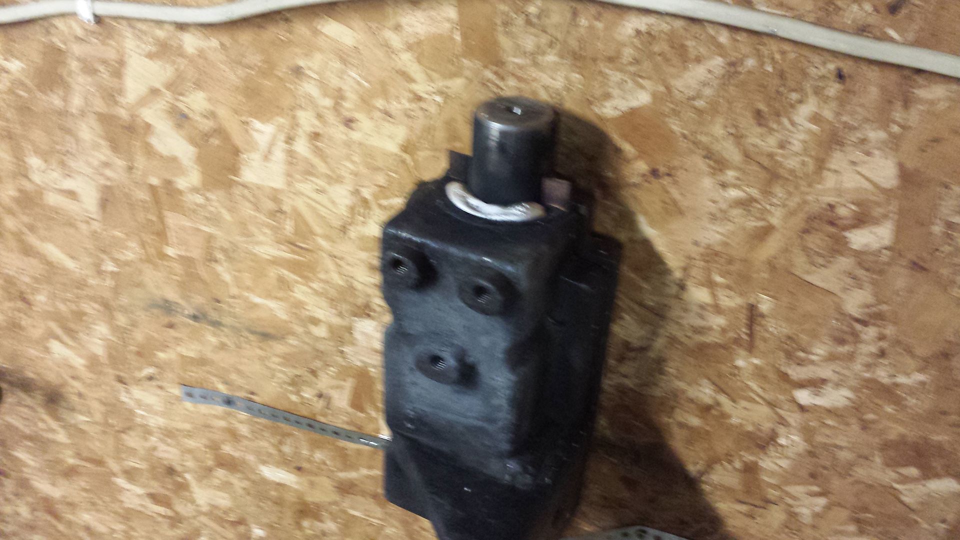

I freed the yoke from its straps that bound it, brought it home and bolted it back in the machine.
Drilled out the wick slots and the oil return holes in the bottom bearings, also cleaned up the ends on all the bearings.
set the mandrel in the yoke, blued the journals and turned it several times.
Pull mandrel and proceed to scrape off the spots with blue.  Repeat.
