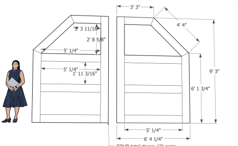

I'm looking for guidelines on designing big doors with Domino XL loose tenons.
I've built standard sized 3 rail exterior doors--but the next project is huge: two pairs of doors about about 5 feet wide X 8 feet tall. Any design or build advice is greatly appreciated.
I'm thinking to build in VG Alaska yellow cedar from my local sawmill, minimum 3" thick, maybe up to 4".

Not qualified to provide guidance but to get the ball rolling I’d say the more rails and the taller they are the better to resist gravity and reduce the strain on the tenoned joints over the years. Given the squat proportions of 5x8 maybe go full fortress and have five rails, resulting in eight panels. Maybe make the stiles wider to keep the panels square?
