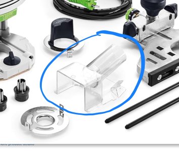

Is it missing a dust “cap”(se last picture)? It’s a ebq plus. Maybe it wasn’t always included?

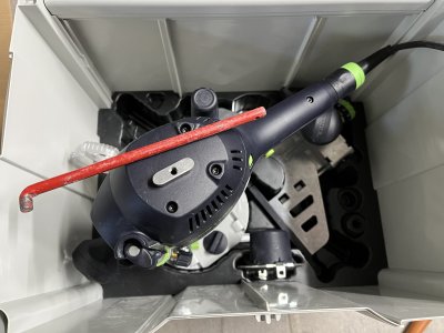

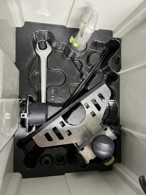

The red steel thing, and the the steel piece beside it was in the box? Any ideas what it is?

The red bar isn't part of the set, no idea what that's there for. The small bit of metal looks like it's a sliding connector for one of the Festool attachments, keep it anyway as it'll probably prove handy at some point.
The Plastic shroud circled in blue should come with the router and is for using with the fence. To be honest I rarely use the fence, and I don't think I've ever used my shroud.
The shroud that's in the case that clips in is great, and you're likely to use it a lot. It pretty much captures all the dust.

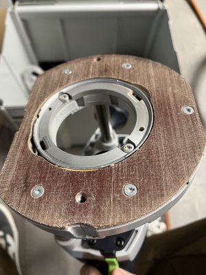

Definitely not "used once", but looks in great condition and I wouldn't really be too concerned about it's age, I guess whether it's worth though it depends on how much you're saving?
The red thing is not part of the kit. The oblong small piece next to it looks to be the feather key from the MFT/3 table used to locate the rail hinge or front rail locator. Looking at the baseplate scratches I would venture a guess that it was used more than once based on the scratches on the baseplate. What will make this hard to determine if you have otherwise completeness is the fact that Festool has altered the scope of delivery over the years. Things that were affected in delivery iover the years include number of collets (originally three now two), the bushing adaptor (I don't see that but in ing 0459 it is next to the circled part) and I believe also the that circled part which is the dust collector for the parallel guide. 2014 vs 4 years? Possible due to the fact that tools for the US "interrupt" the normal production lines due to electrical requirements and thus are made in large batches and stored for distribution and also some dealers are low volume. You might want to take everything out, organize and take a picture so that we can see better. I see someone else just posted so...
@peter halle 3 collets? Not bad! Here in OZ we've only ever got the 1/2" and 1/4" collets with Festool. From the pic it looks like the bushing adaptor is there in it's place.

That was one of the oddities. We got the 8mm (not popular) and other places where they were more popular they didn't. Never made real sense to me but I have a 2010ish version so I am set.
That bakelite base plate has had more than 1 day of use. :)

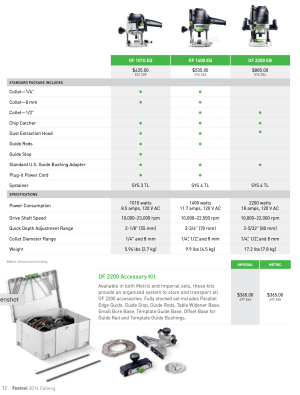

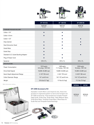

Here's what Festool USA says came with the router...a catalog page from 2014 & 2015.

The kit you have looks relatively complete - especially considering Cheese's references. If you're happy with it and the price, I say enjoy it.
is it missing a dust “cap”(se last picture)?
Apparently. But that part is easy to die when dropped

Red rod not part and the metal part on top as said before probably from MFT.

The phenolic sub-base is a bit worn, but as suggested by Coen, used on a rough surface. The way that all of the scratches are aligned perfectly, I would guess that was done at one time, not necessarily "used once". It could have been used on smooth surfaces, during other times. It could also be that the person used it exclusively with either the edge guide or on a guide rail. (though that doesn't seem likely, since the parts are not there)
