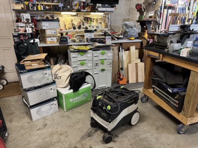

As I was returning from my trip to New England, I swung by a Marketplace seller who wanted to unload a CT-ASA Boom Arm 492753 for $45. He bought it years ago but never installed it and had the parts sitting in the opened box. As we chatted, he said that he thought the arm needed the CT handle to mount it and that I could take the handle from the CT22. Then he said if I wanted, I could take the entire CT22 as well. But, while the motor still worked, there was some kind of hole somewhere in the vac that rendered it unusable.
The CT22 is sitting in the garage but I haven't looked at it yet. As I was sitting here thinking about it, I wanted to ask if this sounds right. Is there a section of the CT22 that requires a full seal to create the vacuum? Or is the vacuum created solely by the motor and blower? I'll get into it tomorrow but just was interested in a primer. Thanks!

Another fan of the CT-22. Mine just keeps working (knock on wood). I'm going to wager there's a blockage at the inlet. That would eliminate suction and make the motor sound like it was working too hard, which someone might mistake as a "hole".
I don't know why the actual CT is only 10% of the picture, but ok. At least that gave us the chance to spot the box of CT 33 bags. Beware; those are a size too big. They will fit, but will sit with creases in the tank.
Looks like the front corner is cracked all the way to the hinge. There might be more damage internally. The 22 is a weird design. When the top is flipped up to change the bag, it's prone to tip sideways, especially when outdoor on uneven surfaces + wind. It's also easy to bump into with the same result. That probably happened here, hence the crack to the hinge.
You absolutely need a seal between inlet and bag and then from the filter to the housing to prevent dust bypassing bag and/or filter. Any leak elsewhere will just decrease the max. vacuum and airflow through the normal inlet. This will make it pretty useless very quickly. Well, and if you suck liquids without the special container it might leak too.

Well, finally got into the garage to see what was up. It looks like it had been sitting outside for a week or so with pine needles and leaves. Cleaned it up, plugged it in and it works fine. There is a crack just above the joint on the right side but I didn't think that would cause a loss of suction - my theory is that the vacuum is generated by the blower, so I don't see how a crack or hole in the casing would necessarily affect that. There does look to be some kind of repair on the inside of the tub though.
From what I can tell, the motor runs strong, generates good suction, the variable speed works and both Manual and Auto functions work as intended. The filters were perfectly clean on the inside and a little dusty on the underside facing the bag. The crack broke through and separated the joint from the casing. A little CA glue and it's holding well enough. After checking it out and giving it a go, I think the CT22 is in great shape to work. So, I cleaned it up, reinstalled the handle and cable wrangler, added the hose hanger and mounted the CT-ASA Boom Arm. And since the vac didn't come with any hoses, I installed the D27/22x5m-AS-GQ-CT hose I got last week in Maine.
