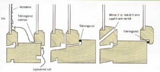

Why do you want to put a new deeper rabbit on the sash? If you can post a picture of your window frames and sashes.

Tim: The reason I need to do deeper rabbit  is that I need to replace the window glass from 2mm to 3mm thick in the inner frame. Look at the intersection on the far right in the picture below.
