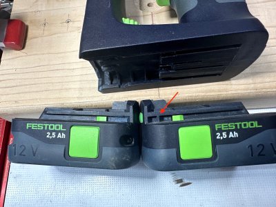

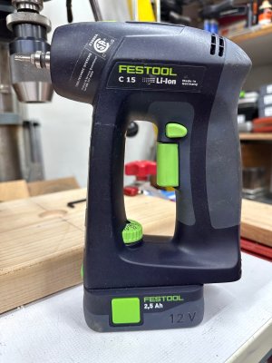

I decided to take Mino's advice and modify the new BP 12 Li 2,5 C battery pack to fit the C 15. A small rib needed to be removed from both sides of the battery pack. What you wind up with is a super light weight drill assembly that actually feels lighter than the new CXS 12 drill. Everything appears to work as it should. I'm curious to test it against the CXS 12 for driving smallish lag screws.

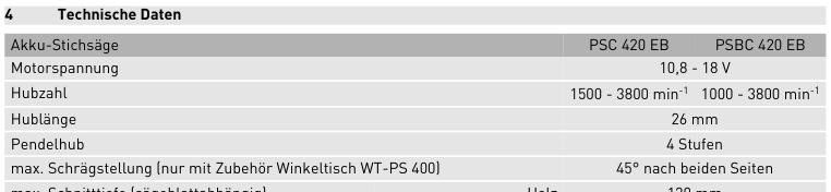

The same packs will most likely work with the current CARVEX, the C/T 18 drills, the PDC/DRC 18/4 as all those are 10.8V-18V range tools.
The most interesting usage is the CARVEX where the weight difference compared to a 4.0 HP pack is significant and helps with agility. I was using my PSC with the old 12V packs for that reason.
Also the PDC/DRC when one needs the high speed but not power - at 12V the tools have less power but not that much lower top speed.
What??? That's a pretty compelling reason now to get the C15 - since I've got the CXS12 and the batteries. Thanks for posting your results!

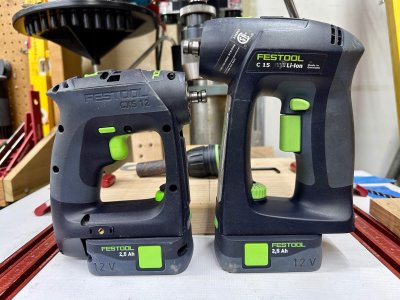

Here's an interesting comparison...the C 15 is lighter (?) marginally but look at all that extra trigger room space for folks with larger hands. :unsure:

I find it’s also easier to use the “C”s out of position.
