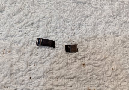

My switch was very loose on the C18 and it was snapped in half. Where did you get another spring for yours?
If anyone knows how the spring is supposed to go in there, that would be great to see. Here is my broken spring.55f6acd1-75d2-45bb-bb7f-9e135fde4c6d~1.jpg
Update: This is the part Plate spring TDK 12 and you need 2 of them. Now the question is how they install in there?
