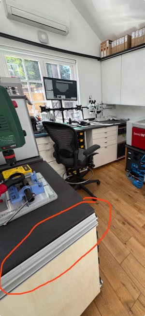

I found a 3D model of the MFT and have been 3D printing lengths of that to attach to custom tool carts and worktables. It then allows me to use the trimming attachments to extend all sorts of workstations.
Here’s a version of that MFT profile for wall mounts:
As for the Kapex 60 vs 120, when I saw the 60 I wanted to sell my bulky 120 and go with the 60, but the plastic tray arrangement for the 60 put me off as I want to attach the trimming attachments directly to the saw.
