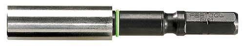

Unfortunately Festool's BHS 65 CE quick-change bit holder may lock on to a ball-detent bit, but it has more slop than a standard ball detent chuck like you would find on a 1/4" impact gun.
Also, I'm not sure how well Metabo's or Fein's 1/4" chucks work, they might be just as sloppy as any other quick-change chuck.
