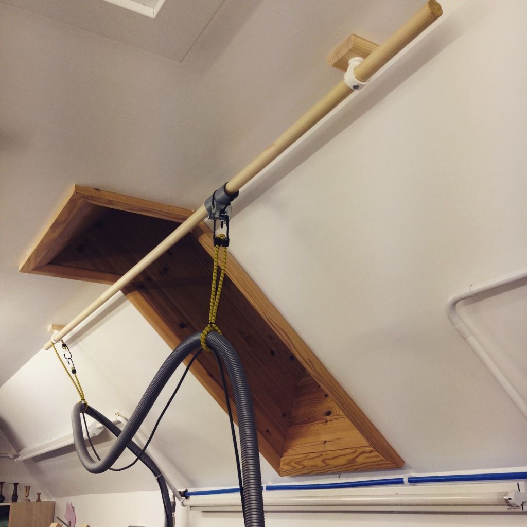

Funnily enough woodwork wizard I had a similar idea this weekend, great minds & all that malarkey.  I used an 8' pine dowel, a couple of pipe clips & a piece of plastic waste pipe.
This is my effort.
Seems to work well & considerably cheaper than a boom arm
I like both ideas. Thanks for the inspiration.
Still need to think about "my" final solution.
This weekend I installed a hook in the rafters of my garage. I simply looped a piece of bungee around the hose and added a clip. I need a sliding solution like yours I'll probably consider this design. Thank you.
