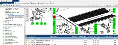

I was in Woodcraft yesterday and saw a scale on their CMS. My CMS-GE did not come with a scale. I can not find the scale on EKAT or as an accessory. Where can I get the scale.[attachimg=1]

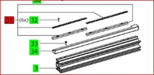

Its not a part of the CMS GE, but (maybe more types) a part of the ts75 insert.
It is partnumber 493761
I have the 75 insert and it is listed in ekat at the 75 insert
As you probably already know is that the table in your picture is not a CMS-GE but a MFT/3-VL.
The scale for this table (493761) should also fit your CMS-GE because it has the same screw spacing as the scale itself.
At least in Europe because the MFT/3-VL is NAINA to my knowledge.
Aha, I thought the CMS looked oddly wide, but couldn't quite place it.
The MFT/3-VL is in the USA Ekat, so he should be able to order the scale.
