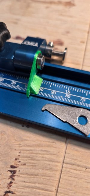

Heya folks,
Haven't posted here in a while, but as I was doing some late night shopping for new tools, and saw the price of the new stops, I decided to draft something up to replace the metal stop with a 3D printed one.
Have a few refinements to make, but will have the files up online after its done.
Here is one of the prototypes I printed this morning.

You may want to go with black filament .. ideally a matte one. Better contrast with the white marks.
I'm trying with a few different ones, but I'm leaning towards matte Orange as its the best contrasting colour with blue.
Stay tuned!
Prusa Orange it is then. Oh how do things converge!
:D
Haha, pretty much, I grabbed some cheapo stuff from Amazon that I'm waiting to arrive for the final revision print... then I'll post pics and links to Printables and MakerWorld.
