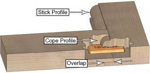

Has anyone used dominos to reinforce a cope and stick joint? I am making a pair of TDL glass cabinet doors and wondered if this is a good idea. Thanks for replying.
greenvillager said:I am thinking to cut the mortises for the dominos before the shaping of the cope and stick?
mike_aa said:The OP indicated these doors will have glass. IMHO, I would not rely on cope and stick only for this type of application. After, all, window sashes had mortices to strengthen them.
