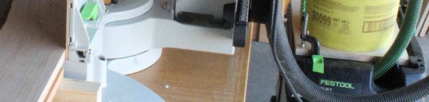

If I were really concerned about consumable costs, I'd use the CT15 with a Dust Deputy, as I did with the previous CT26 (I never needed to replace a bag after two years of ownership of the CT26):
