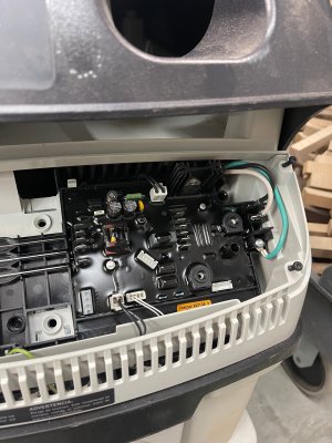

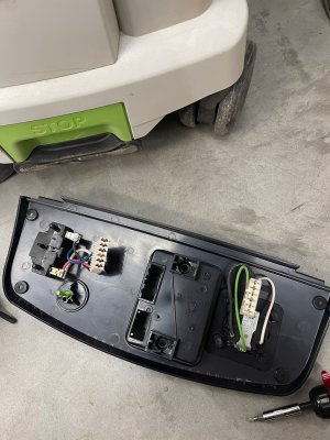

So far I took off the front cover to examine the control board and can't visually see any loose connections, melted areas or components. Not sure if I need to go deeper to inspect more areas? There was a decent amount of dust covering the panel that I blew off before taking the pics attached.

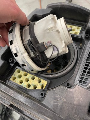

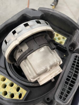

I also accessed the motor and when I was blowing the inside of it out I did smell some sort of burnt plastic smell much different than just normal dust smell. If I had to guess that's not normal?

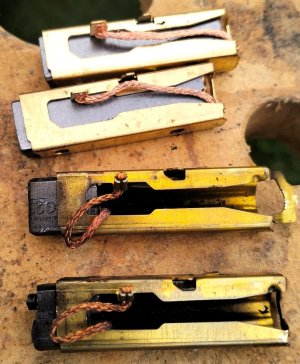

Seeing as you have the motor out, have you checked the brushes as the first point of call?
That they're long enough, and aren't encrusted with crud that could stop conductivity?

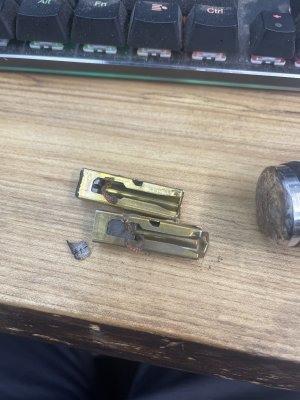

Thanks for the reply.
Yeah after more research these seem to definitely need replacing. Ordered some new ones through Lee Valley and hopefully this will solve the problem.
“the vacuum does not turn on with the sander or by itself in manual mode.”
Classic symptoms of expired brushes. Festool brushes have a nylon rod embedded in the graphite so when the brush wears down to the start of the non-conductive rod the circuit is broken.
