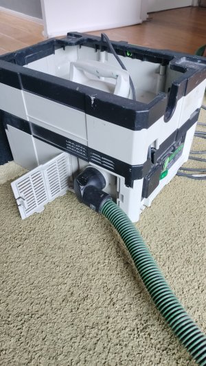

You do know that the CTL Sys has a blower function, right? You can simply connect the hose to the air outlet (hidden behind the grille on the backside of the unit). Turn it on, shake the hose a bit while blowing et voilà, most of it will be gone in seconds.

For the drywall dust, I’d connect it as pictured, lay the hose down, give it a few whacks. Turn hose around, repeat. That should suffice.
