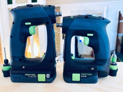

The CXS 12 and CXS 18 weigh the same but there's more space for fingers on the CXS 18. There also isn't much difference in overall size between the two so they handle similarly. Here's a shot of the additional finger space. The CXS 18 also has about 30% more torque.
Very interesting, I assumed the 18 would weight considerable more. I wear XXL gloves so the 18 may be the way to go. Thank you, very helpful.
