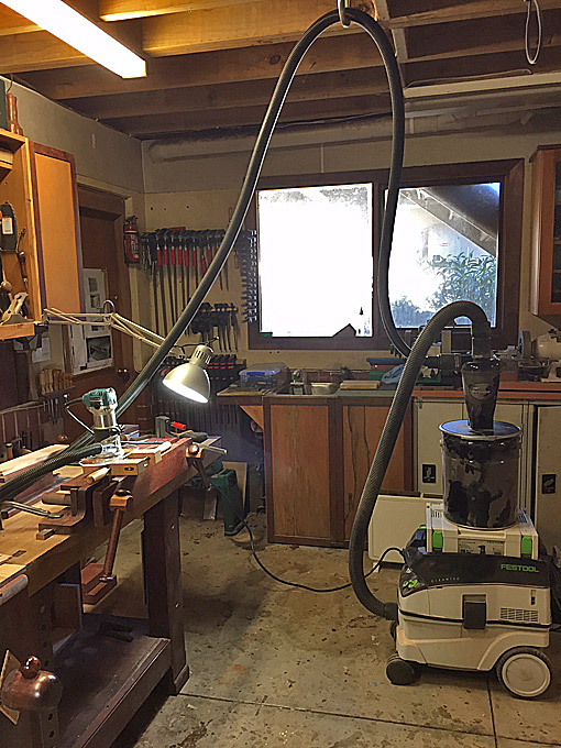

I made one like this about 4 or 5 years ago. From experience, as you discovered, the paint tin needs to be strong enough to withstand the forces of suction.
The machine here is a Festool CT26E.
With Festool, you need anti-static, and the Dust Commander cyclone (on eBay) is made of anti-static material, but so are the hoses and all the fittings. It does not help to some and not all.

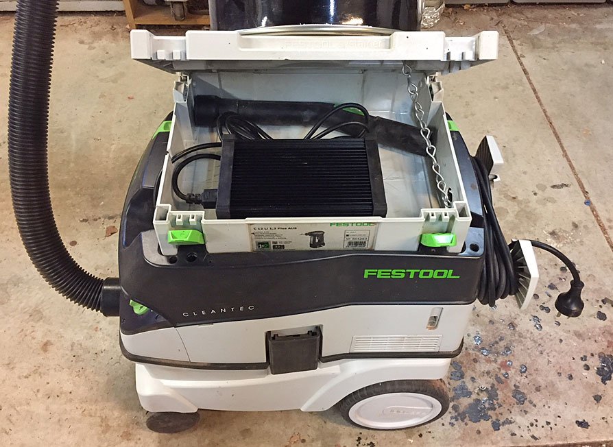

The other difference is that I use a smaller Festool systainer. The paint tin is attached to this. This arrangement has two advantages. Firstly, it is quicker to build and a sure fit  :)  and the second, the inside is a useful container ...
This is where the transformer for a Mirka sander lives. One could also keep hose attachments in there ...
[member=4358]derekcohen[/member]  Is the paint tin permanently attached to the systainer lid? Or can you remove the tin to empty? Cheers
The paint tin is bolted to the systainer. To empty, the systainer is unclipped, and the combination carried away (The systainer - originally for a C12 drill) is compact, so this is not an issue).
