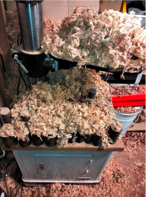

When I'm drilling my door stop blocks I generate a huge amount of curly shavings, the DD just laughs at it.

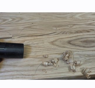

It so happened that I still had some shavings left on the bench from this morning session. Minutes ago, I took these before and after pictures of the DD extracting thr shavings with no issues.
Sometimes I wish all tools made big chips (like when the dust bag in the vac gets a tear) but then I see this photo and, no thanks. Let the debris be small so the vac can take everything.
The issue is the hand plane shavings are long and wide; up to the length of the board. These are not traditional power tool shavings.
