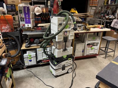

I have the CT-VA-20 and got a good deal on a used one on Marketplace. If time isn't a critical factor, and you don't mind trolling Marketplace, you can find a good deal on one. And while the math on my end says that it would take me until 2035 to cover the cost of the VA vs bags, it's a nice unit and I have yet to replace the MIDI bag in the 7 or 8 months I've been using it. Plus you can stack Systainers on it for better space efficiency. I have the vacuum attachments and Toprock on mine.

My CT-VA sits on top of my Midi and works perfectly.
You could even argue that the hose has a more direct path from the Midi to the VA, since it doesn’t have to turn a right angle out of the front (though I’m not sure that would affect performance).
I have never tried to run a 50mm hose out of the opening of the garage on the Midi, but I expect it would fit, if you’re aiming for a hose that wide.
It’s pretty expensive for what it is, but I often find myself stacking a systainer or two on top, which I find super convenient.

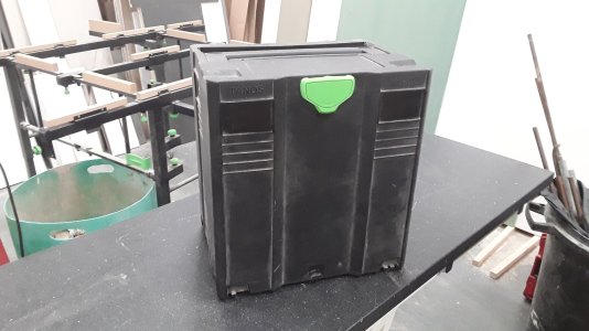

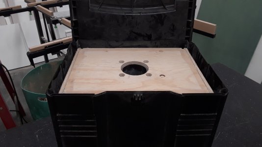

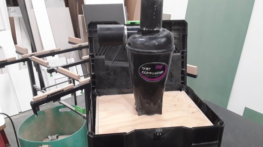

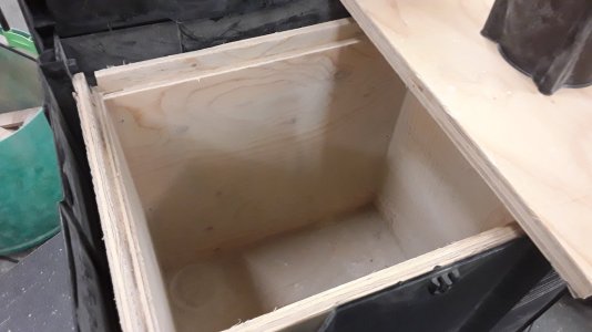

Nice! Does the “DustComander” flip over and fit in the systainer for transport ? By chance.
Yes,....In the second picture, you can see the plywood top with the dust commander connected to it and the complete top fits inside the plywood liner in an inverted position.
It's just a matter of opening the Systainer, remove and flip the plywood top, connect the 50mm couplings and it's ready to go.👍
