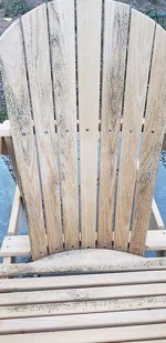

All the chairs have started to get these stains on them and I didn't know what they are. They look like mold/fungus but I don't think that's what it is, would appreciate your thoughts.

Looks like surface mold.  30 second outdoor wash should take care of it easily.
Thompson's might work in the North, but it's the kiss of death in the Southeast.  Guaranteed to mold and mildew wood products.

If those stains are unchecked, it will continue to darken almost to black.  It's for that reason, I don't use cypress for outdoor furniture anymore.
I've had good luck with a product called Wet and Forget
