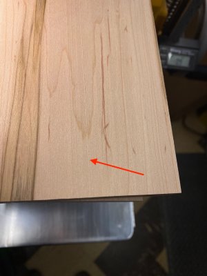

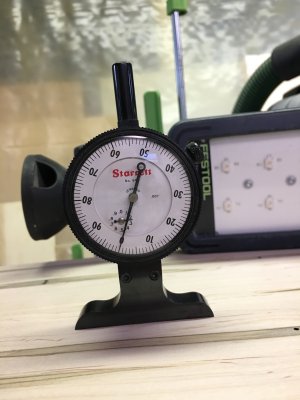

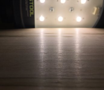

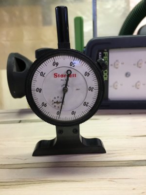

I also installed the original size Shelix in my 735. This is what the wood surface typically looks like, a series of very uniform & shallow "waves" across the entire surface. The depth of the scallops is about .001" but they sand out very quickly using an ETS EC sander with 150 grit.
Where the Shelix really shines though is on figured wood, specifically birds-eye maple.

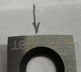

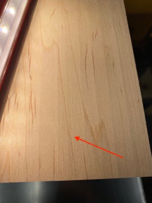

I also had longitudinal ridges from time to time and it was caused by this small, almost imperceptible chip in the carbide insert. Just a heads-up...you have to look at the individual inserts very closely.

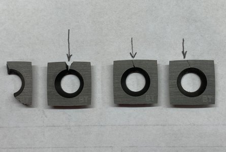

There was also a time when I was getting a lot of cracked/chipped inserts because when I reinstalled the inserts after installing the new cutter head, unknown to me, there were very small pieces of ??? under some of the inserts. Everything was torqued to the proper value of 40 in/lbs.
Oh wow! Thanks cheese. Looking at the 9363 picture I could not believe that small chip would leave a ridge. I sure will have to inspect all cutters closely.
Got it. Everything single cutter will be removed and inspected. Geez! Did not realize it would mean so much work! Guess it would be worth it once everything is fixed right. Will report back.
