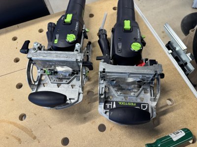

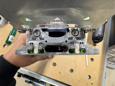

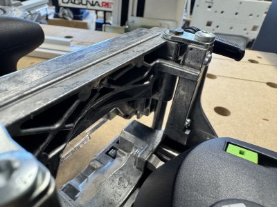

I've been curious about the differences between the R and the Q, so I brought the Q with me to my local dealer to see the differences. And while I'd like the new fence, I'd be okay with the spring adjustable lever locks on the R that would be "authentic" to Festool, instead of the McMaster-Carr versions, which doesn't have as svelte a design.
The idea was that, if they fit the Q, I would just buy the Clamp Lever 10866442, screw it in, and be done with it. But I wanted to make sure it fit correctly first.
Spoiler Alert: Total Fail.

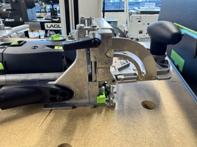

I don't recall the threading on the Q Threaded Pin 465575 - I think it might be M5, but whatever it is the Clamp Lever is bigger (maybe M6) and does not readily fit the Q fence. Also, the design of the Clamp Lever makes it pretty much impossible to install (at least I wasn't able to figure it out). The difference in the design of the two fences is dramatic and, in this respect, incompatible.
Then there's the Base adjustment R Lever 465079. Again, a completely different assembly than the Q fence. In the R, there's a long Pull Rod 469040 that runs the width of the fence. Again, these parts are incompatible with the Q fence.

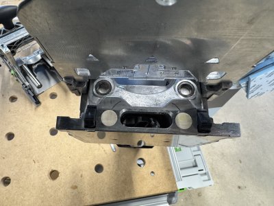

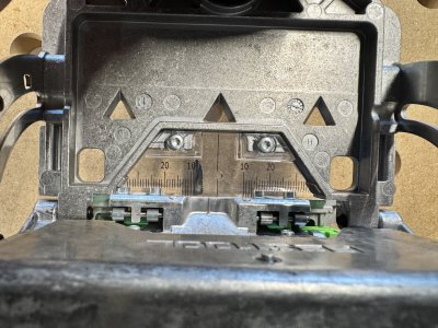

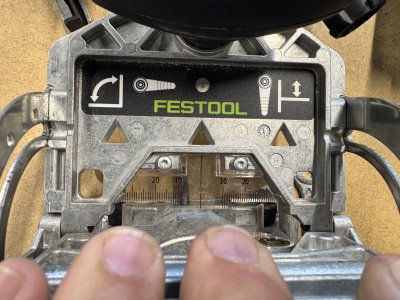

I also wanted to see the fit of the R fence on the Q Domino. It slides together easy peasy. On first glance, when you plunge the Domino to see the bit, it looks way off-center. But I think this is more due to where the lateral motion of the bit stopped. So I put the Q fence back on, and it was in a similar offset to center. From what I could tell, it seems like a plug and play swap. Not sure what issues Millard ran into but it looks to me that - maybe - you might need to adjust the clear center scale - maybe.
Thanks to my dealer for letting me tinker with their display model, but I think it would have gone a bit too far if I powered it up and started cutting with it to check the fence alignment. I do think that it will either be on the money or very close (within adjustable range), should someone be considering spending the $500 to replace their fence.
Note: just to clarify - the photos of the fence alignment are of the DF 500 Q on both the R fence and Q fence. The Q fence is the one with the Festool logo.

Thanks for the report! Which fence is img 3537? The reticle alignment looks way off. Do you think that is in adjustable range? If it is off that far, I wonder how reliable the pins are.
Seems crazy it would be centered with the bit in both cases.
Img 3639 looks good. Is that the new fence with the old domino or the new with new?
Actually, 3537 and 3569 are the same fence - the R fence on the 500Q. In the overhead view, it looks way off - but I think that's mainly because the bit didn't stop centered when I shut it down on my last use. The bit is angled to the left. This is why I also included 3542 and 3543 - those are the 500Q with original Q fence. The offset on that combination is also to the left - in about the same position in relation to center. It is because of this similarity between the two fences that I think that the swap might be a bit easier (and with less fuss) than what Millard experienced.

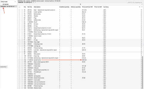

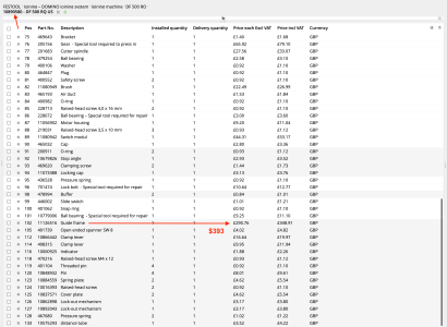

When the R was first announced, I was one of those who thought swapping the fence might be a good route - especially when we thought the new fence might be priced at $350. But at $500, plus whatever Festool would charge for calibration (or just the effort of calibration at home), is it really "value" when compared to spending the money on a new replacement R? Seems to me now that it would be better for the interested, to sell their Q, recoup the $900 and put that towards a new R. New tool, new warranty.
In my specific case, it would be more of a fun luxury to switch because of my use. The vertical fence adjustment is much smoother on the new fence and, theoretically, the additional pins could be helpful. But I don't know the difference. It's cheaper to remain in darkness about their usefulness! :)
I'm with you that the new fence offers better pins but not a deal breaker to spend $500 on just that. Other so-called "upgrades" are not worth anything to me as I'm perfectly happy with my DF500 as is (I am an intensive user, comparable to any users who use it for a living).
However, woodworkers are known to like and chase after new toys or features. I hope those who choose to go down that path will find the conversion process straight-forward at a minimal cost (it won't be cheap if you have to ship in the machine and the new fence to Festool and pay for calibration if that is necessary).
Unfortunately, the pricing has changed dramatically in just 2 months. Back on Feb 20th the price was $393.
Given the enhanced overall robustness of the new fence, the additional functionality of the new pins, the addition of 2 extra pins, the smoother vertical adjustment and the new Kipp style adjustment levers, it was a compelling option at that time as there seemed to be a decent bang for the buck. At the newer price... 🤷‍♂️
