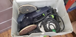

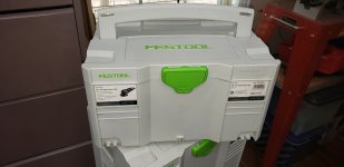

Well I picked up a used complete Rotex 150 with extra pads for $405. Sander and systainer appear to be well taken care of.  It is missing the pad guard and side handle but I  can buy a front handle cheap.  I'll see when it gets delivered what kind of bargain it is.
A quick question, what size is the bolt on the side handle?  I assume it's  metric.
Here's  pics of the Rotex 150 I bought for $405.  I even  got 20+ new Festool Granat sanding disks which weren't  part of the deal.  Overall, I'm  happy with the purchase.
