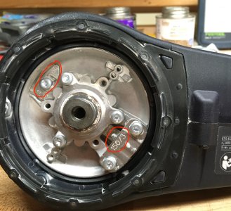

I purchased the ETS EC 125 when it was first released in the US September of 2015. One of the first things I did was to install the 150 mm sanding pad from the ETS EC 150 sander. Ten years later and everything is still working the way it did 10 years ago.
The only differences between the sanders is pad size & orbit size. The "bearing" is different but that's only because it includes the different bearing shaft pad mount that's used on the 2 sized sanders. Here's what you see if you remove the sanding pad from the ETS EC 125...all ETS EC 150 parts.
