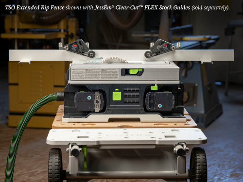

I've seen the TSO fence, but it's out of stock, but also, respectfully, very overpriced for what is essentially a piece of cheap aluminium profile.

I bought the TSO and agree it's overpriced but it was the only solution on the market. I will say the two supports that come with the TSO fall off unless they are cranked on with tons of force. This of course makes them difficult to reposition. I do feel like they took advantage of the new saw coming out with their pricing. Oh well, onto the next overpriced farkle....
Spending 4 extra hours for a solution (besides buying the TSO fence) = just buying the TSO fence, as I did! One meter long was maybe more than needed tho
