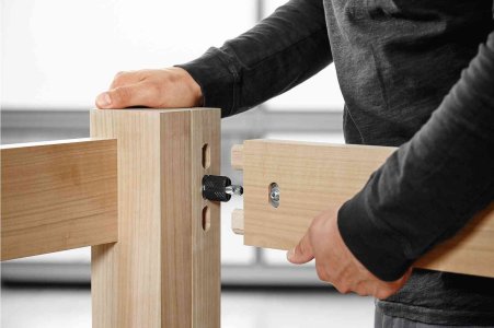

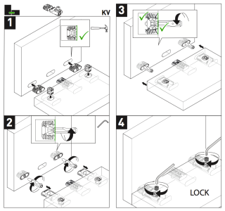

this question is about the domino connector set for the 500.
for the butt joint connectors (D8 50) the product page states “Routing and cutting tolerances of up to 1.4 mm are compensated for without problems by the fixture”
i’m just wanting to seek some clarity on this. Does this imply that if i’m butting a panel and input 3 connectors in where 2 are referenced from the edges and 1 in the centre, that the centre cuts have a 1.4 mm margin of error? There seems to be some play on the receiving end of the connector so that’s my guess but want to be sure.
Also, if that were the case does that make them less useful for flush alignment? is it recommended to throw a referenced wood domino on each panel for alignment?
Thanks!
Yes they have a fraction of movement tolerance, but the alignment factor will always come from using the tenons in conjunction with the connectors.
Yes, Festool recommends at least 1 wood Domino for each joint. The wood Dominos align surfaces and provide strength while the D8 or D14 connectors just draw the pieces together.
