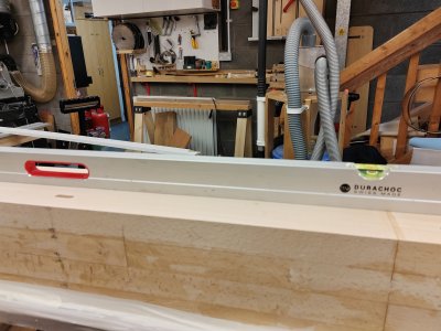

The pic below shows an example of one of the slots where the trouble arose.
The fence slipped several times despite checking, cleaning and careful tightening of the levers - this unreliability together with the loose fitting tenons meant that the tool was set aside and plan B (plastic wrapped clamping battens) used to align the laminations instead.
The longer levers fitted afterwards reduced but didn't eliminate the risk of the fence slipping.
The fence height reset following the first slip was complicated by the fact that the original height setting was eyeballed. When the fence slipped it required multiple trial and error cuts in test blocks and trial fits to get back to it. This was necessary because all slots had to be placed at exactly the same height/distance from the edges of the laminations so that they would end up accurately aligned in the same plane.
Once the fence height was again correct the height gauge which was to hand was used to measure its height above the base - this to make it possible to get back to the setting should as seemed likely the fence slip again.
The fence height could have been set before starting using the height gauge (and the height recorded) or a gauge block on a flat surface which would have avoided some of the hassle - but hindsight is great and the fence wasn't supposed to slip.
The vertical scale which purports to show the fence height setting is calibrated in full mm - it can certainly be used for crude adjustments but was of no use in the above...
Absolutely there is no way the fence could be slipping if the levers are sufficiently adjusted and tightened, and by that I don't mean over-tightened, but if it is and user error has been ruled out, then it must be a fault and ideally should be sent to Festool to have a look at?
As much of a pain as that is, at least you'll end up with a perfectly working DF500.
