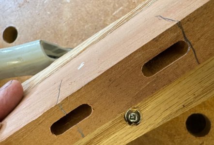

I have run into a very strange malfunction, which causes the mortise slot to, apparently randomly, be displaced left of center by approximately half the full domino width. Festool customer service says they have never had this problem reported before. Has anyone else experience this?
The first time it happened, I figured it was my own error, perhaps not paying attention to the pencil mark. The next slot was OK, and the next, but then it happened again, and again, sporadically. I ran a test on some scrap, and it varied, sometimes allowing me up to 10 correct slots, before the problem recurred. The failure has left me stalled now. I have owned the tool for years, but only used on a half doze or so projects. On those, up to now, I had experienced no problem.

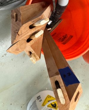

I've not experienced this issue with my DF500. Is the mortice still perfectly formed, is it the proper width? Can you put a domino in the incorrectly positioned domino? I can't see what's wrong in the photo you attached labelled "ruinedpieces" the picture appears to show a bunch of mortices on the wide setting.

Looking at your phot, I'm presuming that you mean it's "off" because the mortise on the right is completely to left of your marking line? This seems physically impossible if you have lined the mark correctly.

Yes, the mortise is perfectly formed, but offset to the left to the center line on the tool, by approximately half the width of the mortise. The photo of the "ruined" pieces shows the result of two passes using the same pencil mark on the center line. The first slot was off center. When I repeated it, using the same center line, it was on-center. So, I glued dominos into the wrong-positioned slot. I will saw them off, and re-cut the mortise in the right position, once I can be assured that the machine will consistently cut the slot centered on the guideline. I am 100% certain this is not a case of user error, since I have now done dozens of cuts on scrap pieces. Most of them come out with the slot consistent with the centerline of the machine, but a few come out offset to the left, always by the same amount. Yes, I am sending the machine back to Festool, but am bracing myself for the possibility that they will only test it a few times, and declare that nothing is wrong with it.
