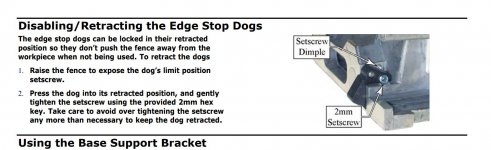

Is there a way to remove the sprung pin stops on a Domino?  I never use them, however I find that they get in they way when lining up the tool for cutting.
While I'm at it, does anyone offer precut sandpaper to stick on the cutter face, to help hold the tool in position?
You can lock the “flippers” back so they don’t get in the way. I think that’s better than removing them because they are still there if you need them.
This must be the older model, with pins, rather than flippers.  I don't see a way to remove them.
The "flippers" can also be locked in the retracted position. The DF500 supplemental manual covers this.  I locked mine out for a few operations but wouldn't want to completely remove them just in case I needed them in the future.
As Sedge says.....I hope, this Helps!
