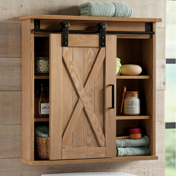

Nice.  Another option is the down-sized barn door hardware designed for cabinets.  The hardware is always on display unlike the drawer hardware which is only on display when open.
https://www.amazon.com/s?k=barn+door+hardware+for+cabinets&i=tools&gclid=EAIaIQobChMI-Zy1-Zag9wIV2gaICR0irAhwEAAYAiAAEgIREfD_BwE&hvadid=582236220387&hvdev=c&hvlocphy=9004205&hvnetw=g&hvqmt=e&hvrand=11488313016947869882&hvtargid=kwd-300746861463&hydadcr=8166_9885022&tag=googhydr-20&ref=pd_sl_tcaok3fcs_e
