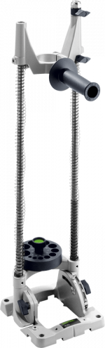

Was trying to find some comments or reviews online unsuccessfully.
Has anyone this gadget and is willing to share his 2c/p?

Hi .think this is a crossover from protool and is a guide for boring dowels/holes in large framing projects
You are right. What I am interested in hearing from our European colleagues that should have used this the most (NAINA), if the ability to angle the base is more a liability or a plus, and how easy squaring the base is? Looks like there are no indents to set a certain angle.
I can't remember to have read a single post on this forum where a member said he owned one or used one.
I have seen only one of these once in a store a couple of years back. Protool version. My first impression was it was very big and heavy, over 60 cm (2 ft) tall. Built very solidly. Spring action was very smooth, and so was the angle adjustment. Not indexed, except for the two outer stops, 90 and 45 degrees. Just move it to one side until you can go no further and you've got 90 degrees, and 45 to the other side.
I have not used it of course, so I don't know how it holds up over time, but considering how solid this was built I doubt it will get sloppy as quickly as the small cheap types.
But it's really big and heavy. Keep in mind it's meant for rough construction, not something you want to use for your typical 'around the house' tasks.
