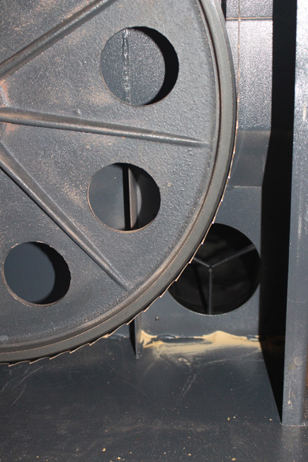

The inside of the bandsaw is usually coated with dust and quite thick on the floor. This picture was taken after a clean and then sawing about 20 feet of MDF with just the lower dust port in use ...
I found that the lower dust port needed to be connected for the system to work optimally. It was not enough to just use the upper collector. However, with both connected, after repeated use through the course of an afternoon, this is the inside of the bandsaw ...
