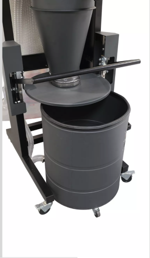

Does Anyone Know Why There is a Hose Connected to this Dust Collection Bin?
onocoffee
Sep 23, 2024
1,541
Baltimore, Maryland, USA

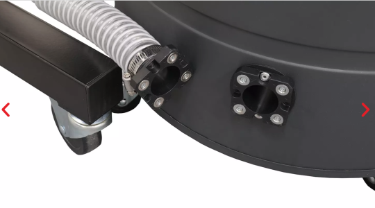

Was looking at photos of different dust collection systems and noticed this feature on a few units. There will be some kind of hose connected to the dust collection bin (the bin where the dust falls into from the cyclone separator). For example, in this Laguna D-Flux.
What does this do? Thanks!

If you're using liner bags...as opposed to just directly into the can...that hose equalizes the pressure and keeps the liner from being sucked up into the dust collector.
EDITED TO ADD: ...or just collapsing in on itself.

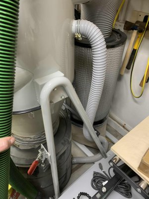

With that in mind, I noticed that on the Laguna D Flux the hose connects the bottom of the barrel to the top of the cyclone. Is this the ideal position for those connections?
I put together a cyclone (Oneida Dust Deputy) for my DeWalt 735 planer and the cyclone drops into a trash can below the table top (the dust deputy is bolted to the top) but I've been getting a lot of blowout between the bottom of the top and where the trash can meets. i had been thinking it's because the blower is just crazy strong but perhaps it's because of pressure imbalance?
I have the first version of that DC from Laguna. The negative pressure hose definitely works. While you don't have to push the bag all the way in for it to work, if you just leave the bag bunched up near the top, the cyclone will pull it in. Never had an issue with it. There should be a little cage around the opening on the inside of the barrel to ensure it can suck air out without the bag simply plugging the inlet
It looks to me that the hose that's connected to the dust bin is connected to the cyclone on the other end? Is this correct?
