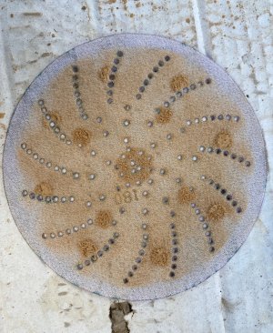

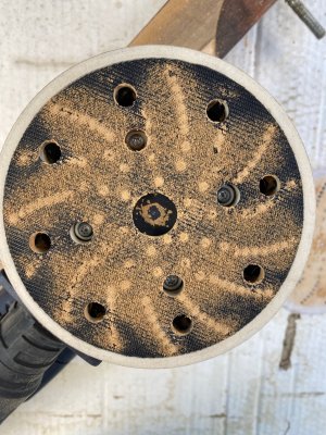

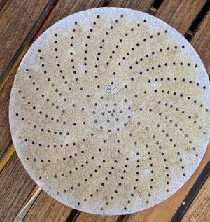

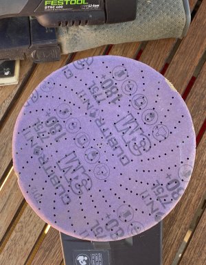

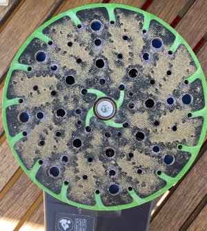

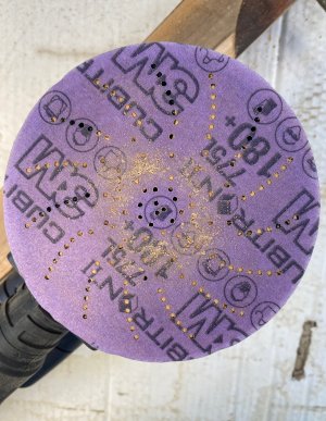

Here's a comparison between dust collection using Cubitron II on the 125 sander vs the 150 sander.
