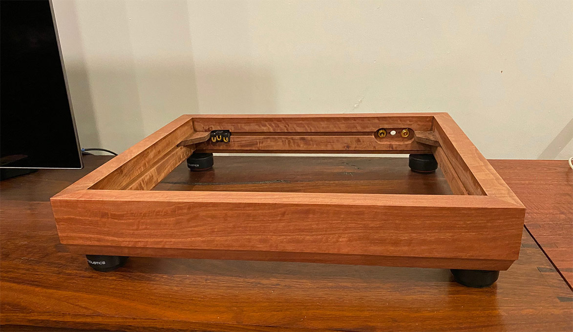

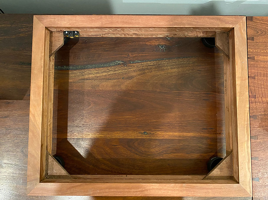

Putting my money where my mouth is, I recently glued up a new plinth for a turntable. The wood is Jarrah ...
The corners are braced internally, but this has more to do with creating a rigid structure than a glue joint ...
When it comes to any corners not closing up perfectly, the easy way to fix these is by burnishing with glue and a smooth, round shaft.
